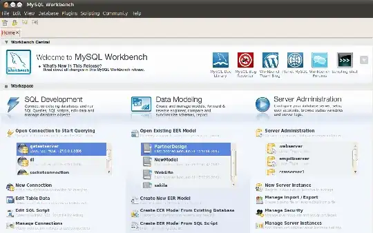

Another good option is mysql-workbench. It can easily be installed using apt-get (the third command will do, yet I prefer to update and search first):
sudo apt-get update
sudo apt-cache search mysql-workbench
sudo apt-get install mysql-workbench
Then you can just type mysql in the HUB and voila.
It works like a charm. There is also a download from their website, yet that gave me in 12.10 a dependency error (the download is for 12.04 so that might explain it).
