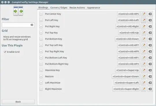

In my case, this can be done with Compiz Setting Manager.
  1. First, you'll need to download Compiz (Skip this part if you already own it).
    sudo apt-get install compizconfig-settings-manager compiz-plugins
  2. Open compiz, then navigate to Window Management category which located on the left pane.
  3. Enable Grid plugin.
  4. Set your own desired shortcut/keybinding for tiling window, simply click the corresponding action key, then change it to whatever you want.

Ctrl+Alt+Num...
Ctrl+Alt+1 => Lower Left
Ctrl+Alt+2 => Bottom
Ctrl+Alt+3 => Lower Right
Ctrl+Alt+4 => Left
Ctrl+Alt+5 => Maximimze
Ctrl+Alt+6 => Right
Ctrl+Alt+7 => Upper Left
Ctrl+Alt+8 => Top
Ctrl+Alt+9 => Upper Right
Ctrl+Alt+0 => Minimize
