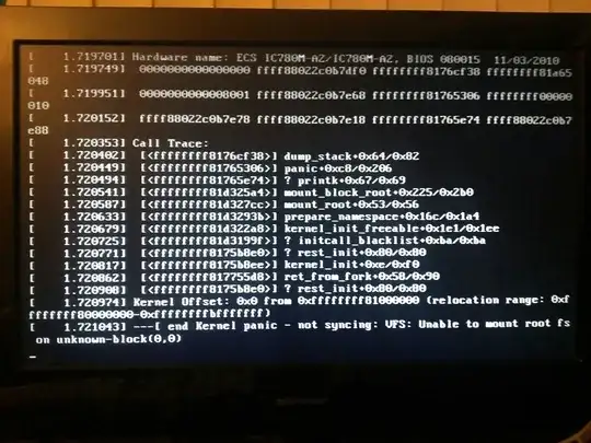

A few days ago I was using my laptop and next day I have this on the screen.
So I installed the HDD on my desktop to see if I can get all my stuff from the disk, but I can't.
This is the message when I try to boot with this HDD.

Unable to mount root fs on unknown-block(0,0) means that you did not tell the kernel what to mount as your root directory. This is normal because instead of having the kernel do this directly, these days it is handed an initramfs that takes care of locating and mounting the root filesystem, but for some reason, your initramfs is missing. Use the grub menu to choose an older kernel that may still have its initramfs so you can boot up, then run sudo update-initramfs -u to rebuild the initramfs.
