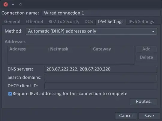

I have set my wired connection to OpenDNS. Without the OpenDNS, I cant access BBC.com. But even with the OpenDNS, my wired connection still cant access BBC.com.It would say page not found.
My wireless connection to the same modem can access BBC just fine. So it seems like despite the settings, my wired connection is not using the DNS
enter image description here The BBC is blocked by some ISP in my country for publishing liberal articles (Freedom of the press is not respected by my government), so it's not the problem of BBC blocking my IP, but a problem from my end of the connection.

It's possible that 404- page not found errors are due to your IP being blocked by the target site and has nothing to do with DNS.
To test if DNS is working, type:
dig bbc.com
If it returns the IP for bbc.com, the DNS piece is OK. To check if a particular DNS server is serving up the correct lookup type:
dig @208.67.222.222 bbc.com # Where @ = the desireed DNS lookup server
Many web sites (e,g, Craigslist) block queries for proxy IPs so you will see this problem a lot if you use a proxy server or go through a VPN.
