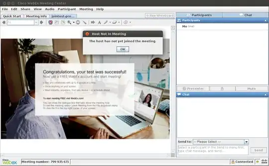

WebEx in VirtualBox
It might be wise to run WebEx inside a virtual machine such as VirtualBox. Without this security measure, the WebEx software will have unrestricted access to your system.
  1. Install VirtualBox:
    sudo apt install virtualbox
  2. Download a 32-bit (i386) Ubuntu ISO and optionally verify the ISO
  3. Install the 32-bit Ubuntu in VirtualBox and run these (and all following) commands there:
    sudo apt install virtualbox-guest-{dkms,utils,x11}
    sudo apt update
    sudo apt full-upgrade
    sudo apt autoremove
    sudo apt install libpangox-1.0-0
    Then reboot the guest OS.
    This enables host/guest shared clipboard, updates the software, and installs a WebEx dependency.
  4. Install Java
    • Alternative 1: OpenJDK
      sudo apt install icedtea-8-plugin
      To remove warnings about missing "Symantec Class 3 SHA256 Code Signing CA" certificate, get the certificate, save it as x.pem, and run:
      sudo keytool -importcert -file x.pem -keystore /etc/ssl/certs/java/cacerts -storepass changeit
    • Alternative 2: Oracle Java
      Oracle Java can be installed via the Web Upd8 Java PPA:
      sudo add-apt-repository ppa:webupd8team/java
      sudo apt update
      sudo apt install oracle-java8-installer
  5. Try a WebEx test meeting
  6. Check whether all dependencies are met:
    ldd ~/.webex/*/*.so | grep -i not
      libjawt.so => not found
      libpangox-1.0.so.0 => not found
    libjawt.so can be ignored. The libpangox-1.0-0 package mentioned earlier should take care of libpangox-1.0.so.0.
    How to find packages containing any other missing files:
    sudo apt install apt-file
    sudo apt-file update
    apt-file search libpangox-1.0.so.0
Notes
Tested with Ubuntu 16.04 host and guest OS. Audio was only tested with Oracle Java.
libjawt.so is not shown as missing with this command:
LD_LIBRARY_PATH='/usr/lib/jvm/java-8-openjdk-i386/jre/lib/i386:/usr/lib/jvm/java-8-openjdk-i386/jre/lib/i386/server' ldd ~/.webex/*/*.so | grep -i not
Screenshot of the WebEx test meeting
screenshot
