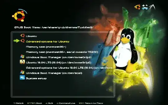

Can we customize the look and feel of dual-boot? For example, make the screen more modern instead of a black screen with white text. Note that I am completely new to Linux (including Ubuntu) and I would like to start compiling my own Android kernels and code, of course. I hate so much the look of the dual-boot screen and I would really appreciate if someone helps me out.
Thanks in advance.

Grub Themes
You can use grub-themes which comes standard on every Ubuntu installation:
Grub Boot
Make Grub fonts
Even if you are just using regular grub, if you want a different font you must use grub-mkfont program first. The same holds true for Grub Customizer used by OP and Grub Themes used in first section of this answer.
Here are the fonts I have made for grub to use:

To create a font use the grub-mkfont program like this guide outlines: Increase Font in GRUB for High DPI Screens:
sudo grub-mkfont --output=/boot/grub/fonts/DejaVuSansMono24.pf2 \
  --size=24 /usr/share/fonts/truetype/dejavu/DejaVuSansMono.ttf
Then in your /etc/default/grub configuration file tell it to use the new .pf2 font file:
# More readable font on high dpi screen, generated with
# sudo grub-mkfont --output=/boot/grub/fonts/DejaVuSansMono24.pf2 \
#    --size=24 /usr/share/fonts/truetype/dejavu/DejaVuSansMono.ttf
GRUB_FONT=/boot/grub/fonts/DejaVuSansMono24.pf2
Finally run:
sudo update-grub
