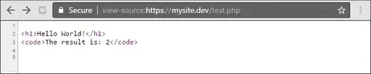

  • The actual result of our PHP program - page's source code is:

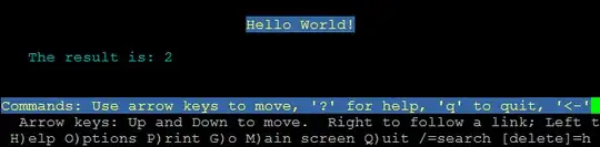

  • If we want to see the result of the interpretation of the HTML code into the terminal, we must use some text-based web browser like as Lynx - lynx http://mysite.dev/test.php:
