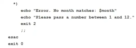

This is (still) the case statement exercise in LinuxFoundation's LFS101x, Introduction to Linux (free course). The code above has exit 2 in the wrong place, making the exit statements meaningless (as pointed out in original responses). In the provided solution to the exercise, exit 2 is included in the case statement's last case, "*", so the case statement exits with an error if given invalid input. Then, after the esac, is exit 0, indicating successful completion of the code if the invalid case (and exit 2) are bypassed.
screenshot of relevant lines of code
