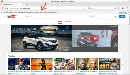

I use Lubuntu, which I believe does not use pulse-audio, or uses a container for that, I do not know, but it seems to use alsa well.

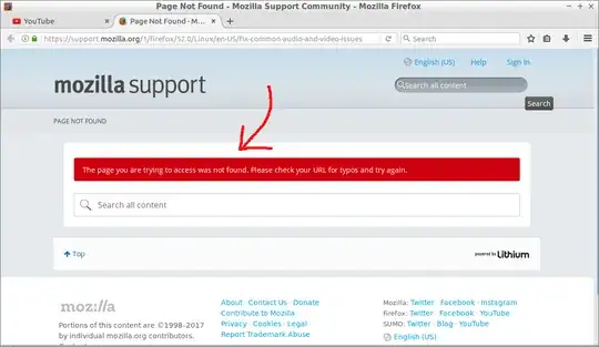

Since I upgrade to Firefox 52, which does not accept plugins anymore, the sound stopped working, and it shows a tip to fix that, but when I click on it, the site does not exist anymore.
How can I fix the sound on Firefox 52 without replacing alsa?
youtobe requires sound
tip do not exists

Firefox 52 comes built-in with pulseaudio as default sound output.
So on a system with alsa only, sound is broken on firefox 52.
You can either rebuild firefox 52 with alsa using --disable-pulseaudio --enable-alsa as compile option switches.
Or install pulseaudio if you dare!
