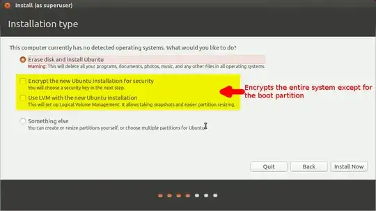

Since there are two methods that you could have used (independently or in combination) to perform encryption, I'll touch on both separately. And then I'll address access from Windows.
You could have encrypted your entire disk with LUKS like this during install![sys-enc.png

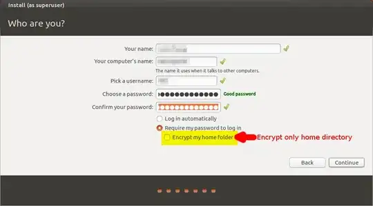

Or you could have encrypted your home directory with ecryptfs like this during installhome-enc.png
Disk encryption with LUKS
If you encrypted your entire disk with LUKS, you may want to look into a program for Windows called LibreCrypt. I have used it with success in the past to access LUKS encrypted partitions from Windows 7.
Home directory encryption with ecryptfs
If you encrypted your home directory, there is currently no way to get at this from Windows. However, it is possible to remove the home directory encryption so long as you have enough disk space to make a duplicate of your home directory.
