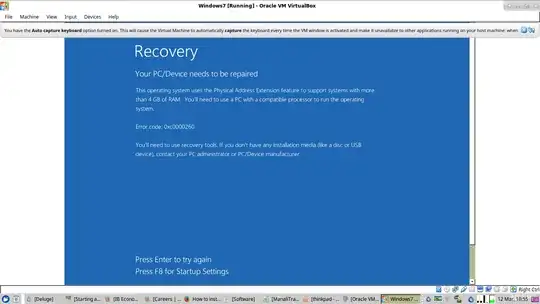

I am trying to install Windows 7 32 bit in Virtual Box on Ubuntu OS. I am getting error (refer snap)
What needs to be done for this.

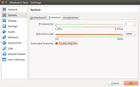

With knowing than Windows error messages usually are not very clear I would suggest you still try to enable the PAE/NX in the virtual machine's system settings.
Of yourse you will only be able to do that in case your host CPU supports this.

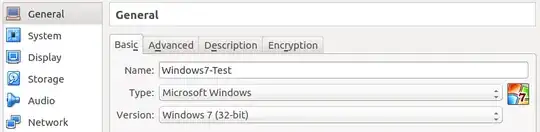

Last not least we should select the appropriate guest OS "Windows 7 (32-bit)" in the General tab of the machine's settings.
