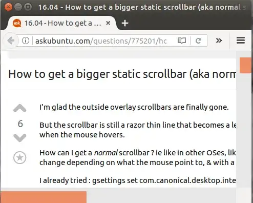

Since Firefox was updated to version 52 on Ubuntu, I started to notice an annoying problem with too thin scroll bars:
firefox-narrow-scroll-bars

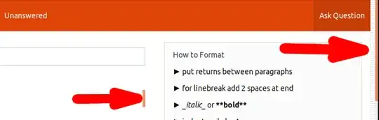

Without anything else this widened the scroll bars in Firefox on Ubuntu 16.04 LTS on a virtual machine:
firefox-wide-scroll-bars
