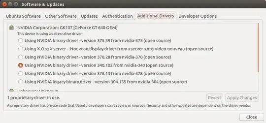

In my recent question I didn't get the meaning of Nvidia proprietary driver. Can somebody help?

All nvidia-xxx are proprietary Nvidia drivers.
They are shown as "open source" because you added an unofficial PPA, probably graphics-drivers/ppa and the system can't detect what driver is there.
You can check the nvidia-375. It should support your GT 640.
