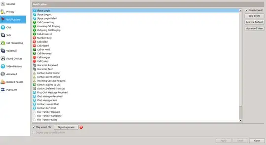

How do I make Skype use the default Ubuntu notify-osd to display notifications (incoming messages, users connecting, etc.) instead of the Skype's own "ugly" message box?

Try
$ sudo apt-get install libnotify-bin
then go to skype options, notification settings, find event you want to edit (for example, online contact notification), check "Execute following script" and insert
notify-send "%sname is now online" -i skype
This worked for me. You can do this with other notifications as well.

Another easy solution based on another answer on this question:
then go to skype options -> notification settings and find the event you want to edit (for example, online contact notification) and click advanced view.
Next, check "Display built-in system pop-up notification"
You can do this with other events as well.
