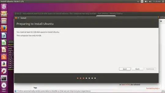

I am trying to re-install Ubuntu as it just isn't loading up well at all. However, I am getting this error:
You need at least 8.5GB disk space to install Ubuntu. This computer has only 4.0GB!?
  • How can I partition the hard drive to make this work?!
This Picture

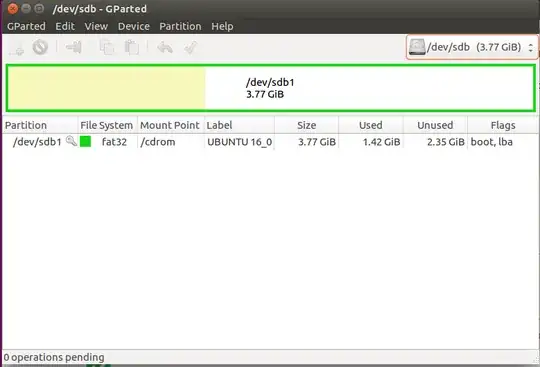

Update: I opened GParted to start partitioning my hard drive but this was my only option.
Partitioning
I have a terrabyte on this computer, why aren't the other ones showing up?

Just to confirm that it isn't recognizing my sda:
only sdb showing up
Please change your partition table, the terabyte of diskspace is not selected. The drive you have choose for installation is a flash drive(usb), here your have to chose Your hdd which will be like: /dev/sda
Have a look again and select right drive.
