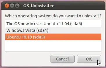

1)Ubuntu-App way
Connect your live USB to the machine and choose "try Ubuntu without installing". After it booted up to the screen, open commandline and type
sudo add-apt-repository ppa:yannubuntu/boot-repair
sudo apt-get update; sudo apt-get install -y os-uninstaller && os-uninstaller
After that, OS-Uninstaller will open and asks you which OS do you want to remove. You choose Windows and it will delete the OS and keep your Ubuntu.

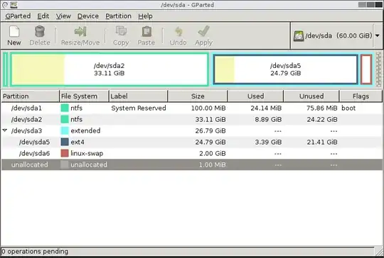

2)GParted way
This way is little bit longer than the other way. You boot your machine with live USB and open the app "GParted". Here, you can see your partitions. Windows partitions are usually formatted as NFTS, so you can see them easily. Choose NFTS partitions and delete them. enter image description here
After deleting there will be exist a "Unallocated" partition. Choose your Ubuntu partition, right click and select "Resize" option. Here you can add these unallocated space to Ubuntu.
Last, perform actions that you did in the GParted app. Reboot the machine and Windows will be gone for good. If you see Windows option in the GRUB menu, you can write sudo update-grub to update your GRUB options.
