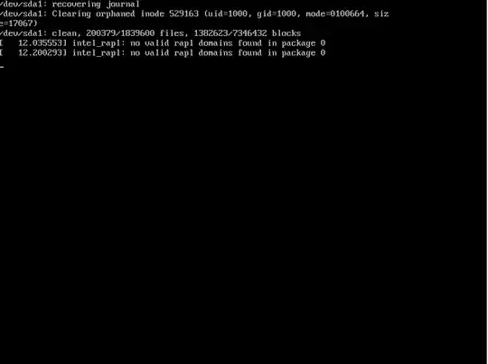

I have set up Ubuntu 16.04 LTS (64bit) on Virtualbox (on Windows 8.1) for many days but this morning, while I was using Ubuntu, the computer became very slow and lag, the memory came up to 90% so I quickly shutdown the machine. After that, I started it again but there was an error.
I cannot login to that machine anymore. I can assure that this is not Virtualbox's errors because I can still login into another tty by using Ctrl + Alt + F1 => F6. But when I typed Ctrl + Alt + F7, it just appeared a dark screen, so I think that is GUI error. I have typed this command: `

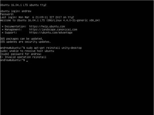

sudo apt-get reinstall unity-desktop
but it said:
Invalid operation reinstall
Does anyone know this error, please help me, thanks a lot.
Below is some images:
The following command worked for me.
sudo apt-get install --reinstall ubuntu-desktop
