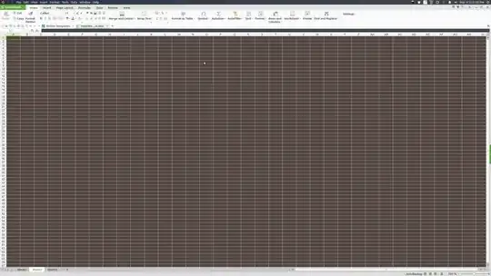

I installed WPS Office for the first time. It is amazing, so much so that I wonder if there is some hidden adware that I can't remove (e.g., what is Docer).
That said, my issue is that the background on WPS Spreadsheets for all sheets is this weird brown color. I've tried changing the Page Layout > Themes and Colors. I've also tried to Format Cells. But there does not appear (or I can't find) a way to change the default background color. Is there a way?
Here is what it looks like.

As with most QT applications, WPS accepts "-style".
For example: et -style motif
This will ignore the current desktop theme, and run WPS with that specific QT theme.
Turns out this is caused by an interaction with the Arc Dark theme (it does not occur with Arc or Arc Darker). I posted an issue on Horst's GitHub page.

I had the same problem, but the solution above given by Dan (which seems to be the right one as it is referenced in every forum I came across) wasn't working for me. But I found another fix which DOES work, although not permanently.
I am using a KDE neon build, and the solution below worked for me:
WPS_NO_KDE_NATIVE_DIALOG=1 et -style gtk+
This is for spreadsheets. For writer and presentation, substitute "et" with "wps" and "wpp" respectively.
Solution attributed to user "raddison" on KDE Forum, under the "WPS Office not working" topic.
