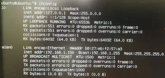

Also this is info from ifconfig enter image description here
P.S. Don't know if it matters - Ubuntu 16.04 server is running on Raspberry Pi 3.

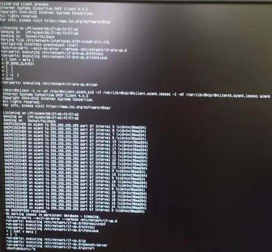

EDITED sudo ifdown wlan0 && sudo ifup -v wlan0 output: enter image description here
