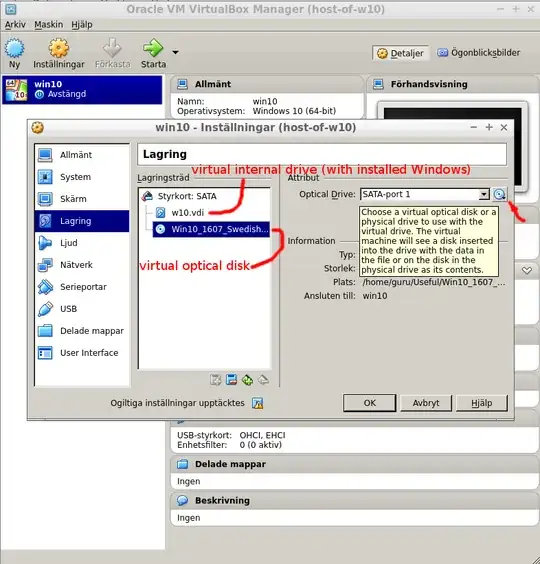

Edit1 : I add a screenshot describing how to connect the virtual machine to an iso file, which makes it possible to boot from it. After booting the virtual machine: press F12 to get a boot menu, where you can select virtual drive to boot from (in this case the virtual internal drive 'w10.vdi' or the virtual optical disk 'Win10_1607...').
choose _virtual_optical_disk
Edit 2: @KarlMorrison suggests to use Windows in the virtual machine as a tool to install Windows into an external drive,
You are actually half-way there with this answer. Install VM on Ubuntu -> Install Win10 in VM -> Boot Win10 in VM -> Install WinToUSB -> Use WinToUSB to install Win10 to External USB
