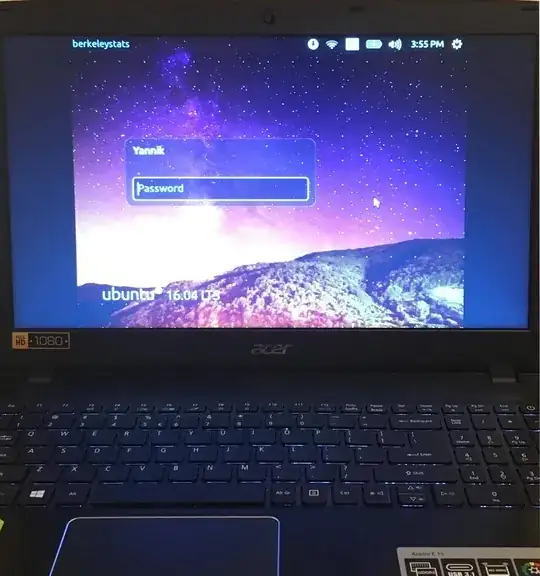

Why is my screen looking so off? I would like to revert to the standard size screen please. I don't know why this happened.

In a comment you wrote: Yes I tried to install cuda. Installing CUDA in Ubuntu 16.04 is known to cause exactly the same error as you described in your question, the desktop is zoomed in and enlarged to huge proportions, such that the login password input box is way larger than it should be and you can't even see all of the icons in the Launcher at the same time. Your problem may have been caused by the NVIDIA proprietary graphics driver that was installed as a dependency of the NVIDIA CUDA toolkit (nvidia-cuda-toolkit). nvidia-cuda-toolkit installs nvidia-367 as a dependency in Ubuntu 16.04. Maybe you will have better luck if you installed the NVIDIA proprietary graphics driver that is recommended for your computer's hardware.
  1. Bring up a text-only virtual console from the login screen, using the keyboard combination Ctrl+Alt+F3 and then you will get a text-only console which shows you a login prompt. Login to the console at the login prompt with your username and password.
  2. Uninstall NVIDIA CUDA toolkit and the NVIDIA proprietary graphics driver from a text-only console.
    sudo apt remove nvidia-cuda-toolkit nvidia-*
    sudo reboot
  3. Identify the recommended proprietary graphics driver for your system. Open the terminal and type:
    ubuntu-drivers devices
    If you can't login and get to a terminal yet, you can run the ubuntu-drivers devices command from a text-only console, the same way as in Step 1.
  4. Install the recommended NVIDIA proprietary graphics driver and reboot.
    sudo apt install <package-name-of-the-recommended graphics-driver> nvidia-settings
    sudo reboot
