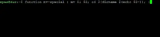

Another approach is to create your own command dedicated for this purpose. This can be done via function which could looks like:
$ function mv-special { mv $1 $2; cd $(dirname $(echo $2-)); }
Where: (1) mv-special is the function name; (2) the variables $1 and $2 are arguments in the function who will be used by the commands mv and cd; (3) $(echo $2-) adds a wildcat character to the end of the string in var $2, and fixes the behaviour of dirname if the variable $2 contains only path; (4) $(dirname $(echo $2-)) will filter only the path from $2.
According to this answer the function could looks like:
$ function mv-special { mv $1 $2; cd ${2%/*}; }
Where: ${2%/*} will filter only the path from $2.
To be available as a command this function must be exported:
$ export -f mv-special
Usage:
$ mv-special file.pdf ../../../Dropbox/sharedfolder/subdirectory/file.pdf
or:
Please pay attention to that - for both variants - the second argument ($2) must finishes with filename or slash (/).
