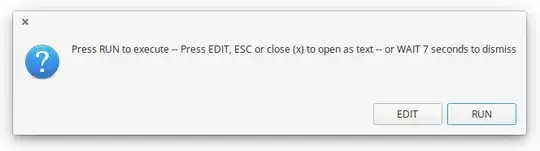

A version of the initial script (somewhat improved based on the comment), which even in absence of action will close the window after a number of seconds:
#!/bin/bash
zenity --question --text="Press RUN to execute -- Press EDIT, ESC or close (x) to open as text -- or WAIT 7 seconds to dismiss" \
       --ok-label=RUN \
       --cancel-label=EDIT \
       --timeout=7
case $? in
    0)thunar $1
    1)gedit $1
esac

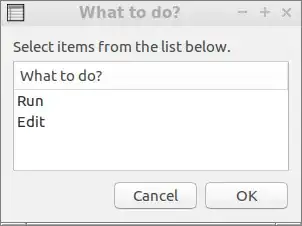

Simple example of a radiolist
There is a simple example of a radiolist in this link,
http://linux.byexamples.com/archives/265/a-complete-zenity-dialog-examples-2/
Example with --list
I think it is easier to use a simple list (with the option --list but without --radiolist)
$ ans=$(zenity  --list  --title "What to do?"  --column "What to do?" Run Edit 2> /dev/null); echo "ans=$ans"
ans=Run
ans=Edit
ans=
