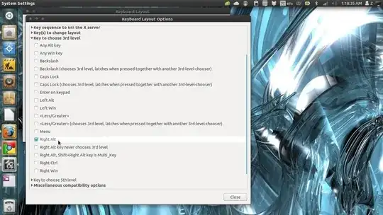

I had this problem / here was my solution.
1. remove the keyboard layout.
2. add the layout back
3. make sure 3rd layer is set to Right Alt
then test Right Alt + backtick -> Shift + E = È & Right Alt + Shift + i = Í
also if this does not work remove and or reinstall xkb-data
