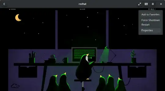

Open Boxes and right-click the stopped virtual machine, then select and click Properties.
If you want to do it while the machine is running, select and click Properties on the top right.

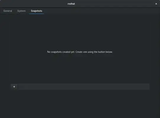

Open the Snapshots tab and click on the + sign to create a new snapshot of the machine.
By the way, I recommend to create new snapshots when the virtual machine is not running.
