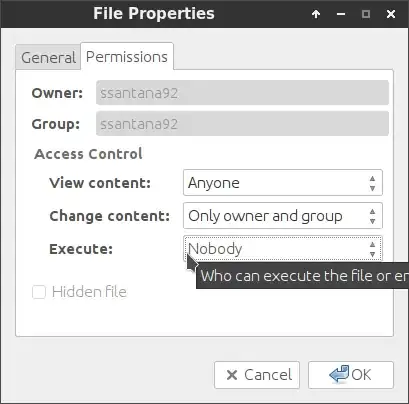

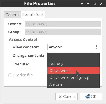

Using a graphical file manager
I'm using PCManFM, but the steps are very similar with any file manager.
  1. Locate your file and open context menu by right clicking it.
    1 - pcmanfm context menu
  2. Select the execute box.
    2 - pcmanfm file properties
  3. Assign permission (owner, group, all).
    3 - change permission with pcmanfm file properties
  4. Apply changes by clicking the OK button.
