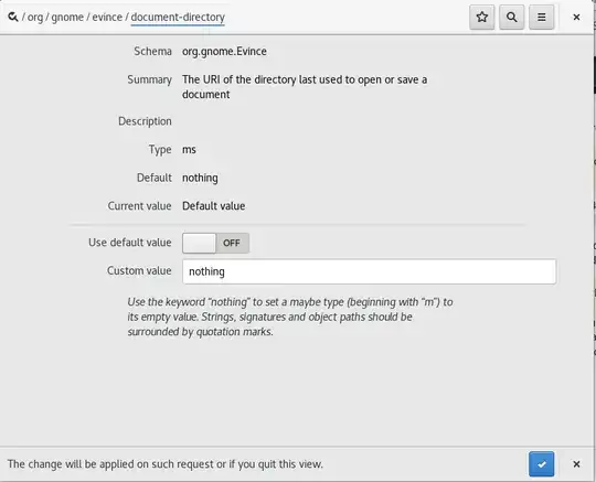

Follow these steps:
  1. Install dconf-editor, then launch it
  2. Search for "evince".
  3. In the document-directory, set 'Custom value' to nothing.
  4. Apply the changes.
  5. After that, if you want, you can press "Use default value" button.
Changing evince save a copy dialog using dconf-editor
