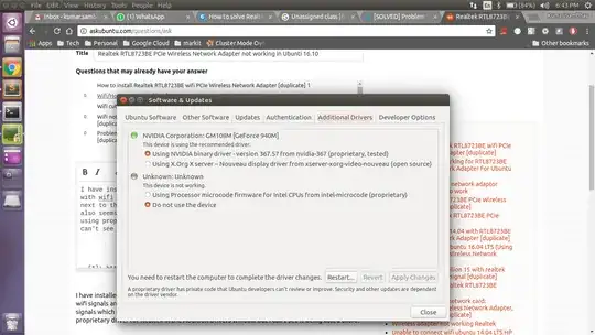

I have installed Ubuntu 16.10 on a Hp Envy Laptop and facing problem with wifi connectivity. The wifi signal is very poor and sitting just next to the wifi router also causes disconnects and weak signal which also seems to drain my battery faster. Some other solution mentions of using proprietary driver for Realtek in the Addition Drivers window but I can't see it being listed there:-
Additional Drivers

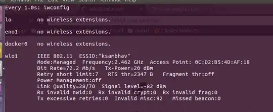

After followinf @Pilot6 's answer, the signal level dropped after few minutes. The following is output of running watch -n1 iwconfig sitting approx. 4 feet away from the router. The connection works when Link Quality is 40+/70.
