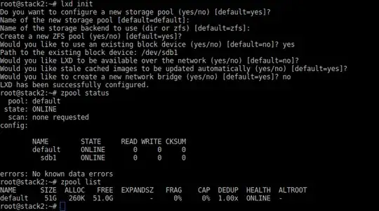

After installing conjure-up, you need to tell lxd to use the ZFS. You can do it by running
sudo lxd init
You can also point it straight at blockdevice /dev/sdb, if sdb1 doesn't exist. It will create the partition and pool automatically.
picture of the process
