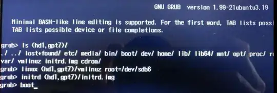

Yesterday, I decided to update my ubuntu 12 to ubuntu 16. I chose the option "remove ubuntu 12 and install ubuntu 16", or something similar. After the upgrade, whenever I choose Ubuntu in the F9 boot menu, grub will launch in console mode.
I followed the instructions in here, as you can see in this photo I took: enter image description here
But right after pressing enter it falls in another console, with an error. I tried fsck as they suggest but then another error shows up: "The superblock or the partition table is likely to be corrupt". After rebooting everything is still the same.

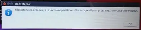

I've tried installing and running boot-repair from a pen, but it gets stuck with the following message:
Even after disabling fast boot on windows this message keeps appearing and doesn't fix grub.

The Boot Repair image is giving the error the partition needs to be unmounted.
Boot to the LiveUSB and preform these following steps.
First ensure the partition isn't mounted:
$ sudo umount /dev/sdb6
Then run the manual fsck:
$ sudo fsck -y /dev/sdb6
Update:
You can manually fix your booting problems by running the steps provided here.
Use these parameters for the steps:
  • /dev/sdX# = /dev/sdb7
  • /dev/sdY# = /dev/sdb6
  • /dev/sdZ = /dev/sdb
