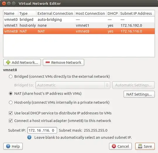

Assuming you have the Virtual Network Manager/Editor though do the following on the system that has the VM that will be the 'server':
(1) Open the Virtual Network Manager / Editor, and select the one adapter with "NAT" as the "external connection" listing. It'll look something like this image shows: enter image description here

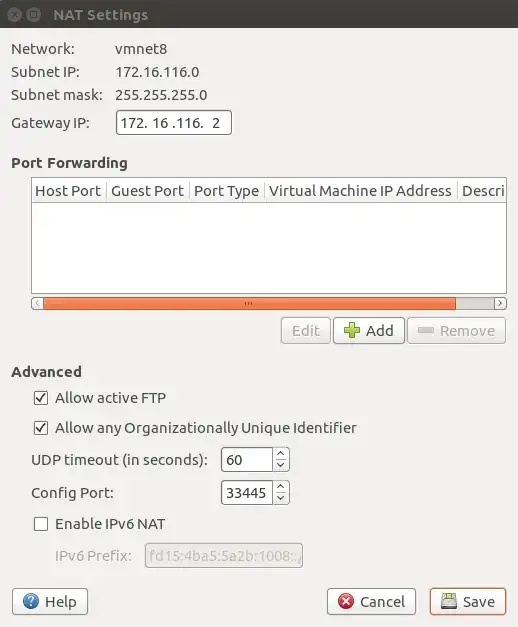

(2) Select "NAT Settings", and you'll get a window like this one:

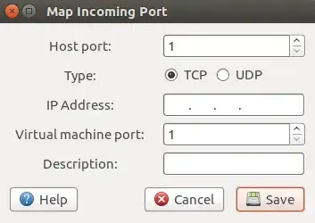

(3) Under the "Port Forwarding" area, click "Add". You get a window like this one:
Set the information as follows:
Host Port: Likely to be the same port you're having the Server listen on in the VM, but it can be something else if you want.
Type: TCP or UDP is dependent on your server and how it listens. Safe to assume TCP here, though, most active-connection server things are TCP.
IP Address: The IP address of the VM. You can get this with ip -4 addr list from inside the VM on the command line.
Virtual Machine Port: The port that the server application will be listening on.
Description: A description of what this port forward is for.
