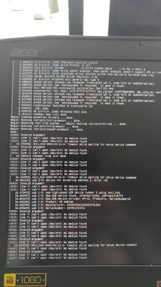

I use a 60 GB SanDisk for the Live USB. Pressing the arrow key while waiting for Ubuntu to load gives me the error /dev/sr0: no medium found. How can I successfully boot the USB media?

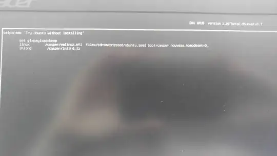

So here is a picture of one set of parameters I tried boot settings and their results results nouveau.nomodeset=0a
This is probably the most hopeful configuration I tried so far

You have very new graphics hardware, which is known to have compatibility issues with the open source nouveau drivers, especially when it comes to the NVIDIA GTX 10xx GPU adapter series.
Boot the Ubuntu installation media you have created and select 'Try Ubuntu without installing'.
Press the E key and add the parameter nouveau.modeset=0 at the end of the linux line.
(Note : Set a Space between the last character in the linux line and nouveau.modeset=0)
Press the F10 key to boot into the Ubuntu Live desktop and start the installation of Ubuntu.
After the installation has finished, boot into BIOS and select Ubuntu as the default system to boot.
Add the same parameter again when booting the freshly installed Ubuntu system for the first time.

In case that the USB still doesn't boot properly, use the parameter nomodeset instead of nouveau.modeset=0. If this also does not work : create a new and properly booting USB installation media as explained in chat and described in the answer to an earlier question.

Regarding the error message in the screenshot can’ t open /dev/sr0: no medium found ...
The kernel does not recognize or can not find a DVD. When you burn the ISO file to a DVD and boot from the DVD installation media, the error message most probably will not appear anymore.
