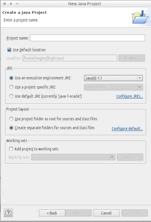

In case you did not already try this:
when you open a project you need to set the environment.
If the environment was already set as 1.6 previously, then you will need to make a new project with the execution environment as 1.7 and import it.
eclipse environment
