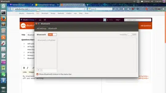

My bluetooth of Dell Inspiron 3521 running Ubuntu 16.04 LTS is always turned off and never working.
see this image
