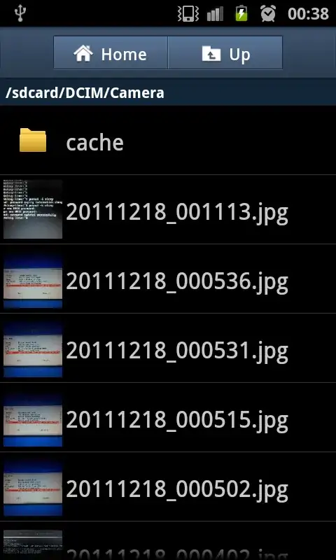

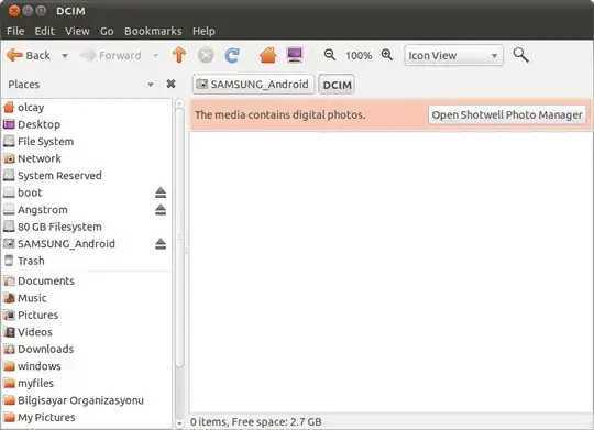

When I connect my Samsung Galaxy SII with USB cable my DCIM folder looks empty although I can see my files on phone. Do you have any idea what would be the problem?
On computer:
Empty folder
On phone:
