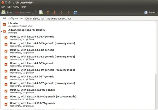

The program is a GUI for handling the settings of the boot loader. There, you can visualize the list of kernels still available in your systems from the tab 'List configuration'
Grub Customizer List configuration

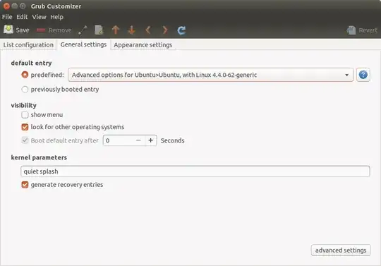

With the other tab 'General settings' I can change the kernel loaded at boot time. In the snapshot below I am set to select 4.4.0-62 generic from the 'default entry: predefined` area. That version is the last but one in the list shown above.
Grub Customizer General settings
Then you save your selection. After the next reboot, the system will start from the earlier kernel as per your selection. If your problem has disappeared, you have framed the culprit. If not, this avenue has not been successful, alas, and the problem resides elsewhere --- you can then revert your boot-loading selection.
