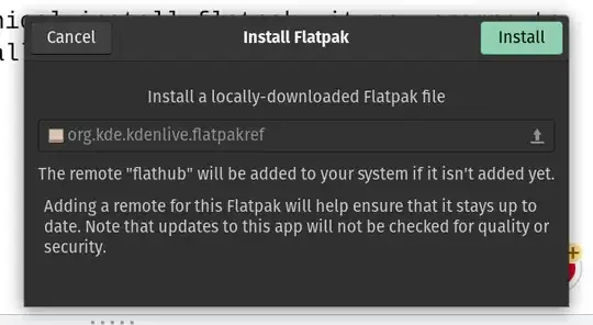

Now I think you can Graphical install Flatpak. It now prompts to a new dialog box to install:
