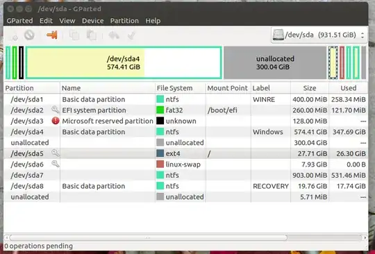

I am using ubuntu 16.04 in dual boot with windows 10.
This is how my disk profile in Gparted looks like, how should I use those unallocated 300 GB (or some of it) to extend my ubuntu ext4 partition, what procedure should I follow?
You can resize the partition through Windows 10. The Disk Management tool should be able to handle this without error. Make sure you backup your files prior to resize, just in case.
Alternately, you could use a live CD/USB and use Gparted.
Either way, you'll select your partition(sda5) and choose the resize option.
