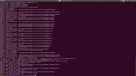

I am trying to install Kodi 16 from a tar.gz file because if I try from PPA it automatically installs Kodi 18 version.
I do exactly as it says on your guides but firstly I didn't find the configure file on the folder as the guide says.
I found the configure file at lib/libmpeg2 I execute exactly the same instructions but after running:
./configure
make
make install
I get errors after running make installas shown:

There is an official PPA for Kodi Jarvis (16.1) available.
You can install it from your Terminal like this:
$ sudo add-apt-repository ppa:team-xbmc/kodi-old
$ sudo apt-get update
$ sudo apt-get install kodi
nb. Please make sure to remove the other PPA's for Kodi, as they will conflict with this one.
