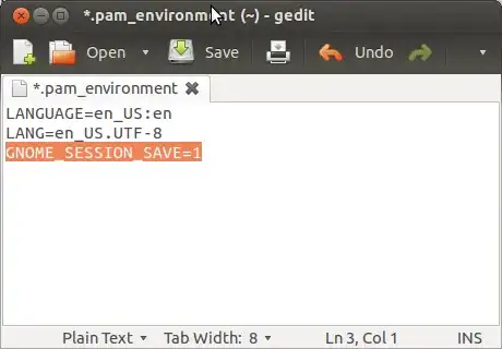

  • You can enable this by setting the GNOME_SESSION_SAVE variable to a non-null value. Here's how:
    • Press Alt+F2, type gedit ~/.pam_environment, and press enter.
    • Add the line GNOME_SESSION_SAVE=1 at the end of the file as shown below:
    • enter image description here
    • Press Ctrl+S to save, and Ctrl+Q to quit the editor.
    • Now reboot (logout should also work, but just to be safe)

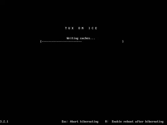

    2. Testing hibernation functionality.
  • Open some of the applications you normally use, e.g. Firefox, Thunderbird, LibreOffice, etc.
  • Open the terminal again, with Ctrl+Alt+T.
  • Type sudo pm-hibernate, press enter, enter your password.
  • You should see the lock screen for a second, and then the TuxOnIce hibernation progress screen, like the one below:
    • If TuxOnIce works, your computer will shutdown.
    • Start it again, and wait. TuxOnIce should resume from the point you hibernated, including all the windows you opened at the position you opened.
  • If all this worked, go to Step 3, which lets you enable Hibernate from the dashboard.

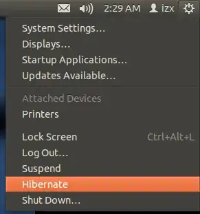

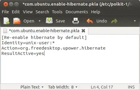

    3. Enabling hibernation from the dashboard
  • Press Alt+F2, type the below and then press enter:
    gksudo gedit /etc/polkit-1/localauthority/50-local.d/com.ubuntu.enable-hibernate.pkla
  • Paste the below, press Ctrl+S to save and Ctrl+Q to exit the editor:
    [Re-enable hibernate by default]
    Identity=unix-user:*
    Action=org.freedesktop.upower.hibernate
    ResultActive=yes
  • Restart, and you should see the Hibernate option as shown below:

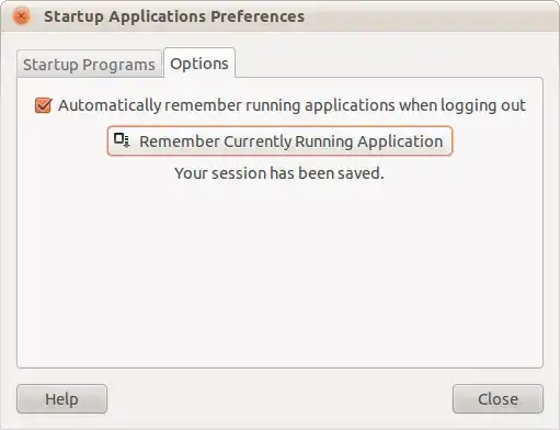

For 11.04 and earlier
Try this
System > Start up Applications > Options and check Automatically remember running applications when logging off and click remember current applications.

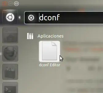

How to save a session on Ubuntu 11.04 or above:
  1. Download and install DConf-Editor.
  2. Type dconf on the dash and run it.
DASH-IMG
Open the next labels in order: org --> gnome
Then select gnome-session
Now you should see the auto-save-session option as the following image, activate it.
APP-IMG
DONE!

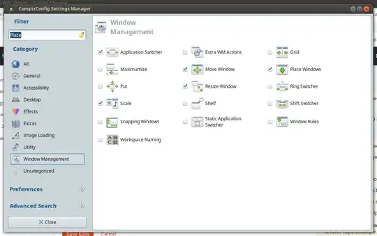

In CCSM, use the Place Windows and Resize Window plugins.
screenshot of CCSM - Window Management
They are in the Window Management category, in CompizConfig Settings Manager.
