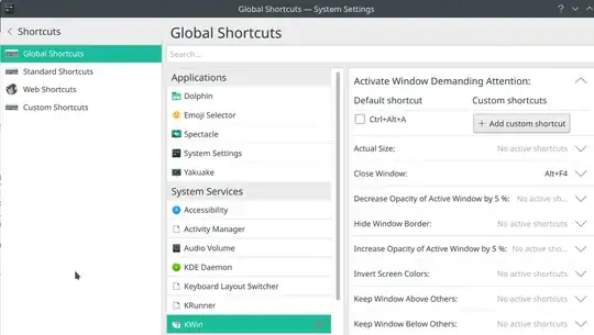

  1. Open Global Shortcuts
  2. Under System Services, look for KWin
  3. The first entry for the KWin section should be Activate Window Demanding Attention
  4. Disable it or change the shortcut to something else
  5. Press Apply
These instructions were tested on KDE Plastma 5.19.4.
Screenshot of KDE global shortcuts editor
