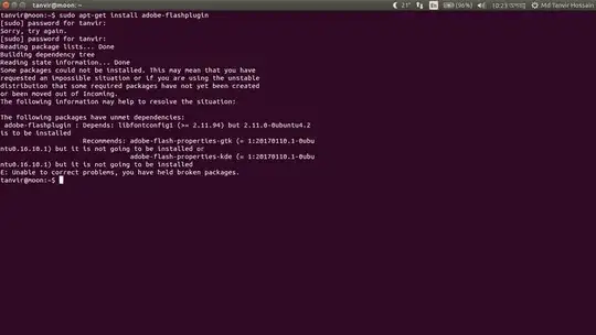

I was trying to install adobe flashplugin in my pc.But while installing it wasn't installed perfectly.I give a screenshot of the terminal while installing.Please help me by recognizing problem and solve it

You added a wrong repository for your Ubuntu release.
Run in a terminal
sudo -H gedit /etc/apt/sources.list
Then remove these lines
deb archive.canonical.com/ubuntu yakkety partner
# deb-src archive.canonical.com/ubuntu yakkety partner
Save the file and run
sudo apt-get update
The plugin should install by
sudo apt-get install adobe-flashplugin
The lines
deb archive.canonical.com trusty partner
deb-src archive.canonical.com trusty partner
are also wrong and should be removed too.
