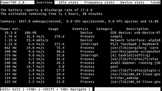

I've been searching and messing around with powertop, tlp, and general power settings for a few days now and just can't seem to get rid of this ridiculous power drainage from a usb device. (Color sensor by Pantone - aka "X-Rite")
Powertop Overview
All tunables are set to 'Good'.
My laptop is a ThinkPad W541 and I am running Ubuntu 16.04
Any help/tips would be greatly appreciated for power saving even if unrelated from the usb device, but the usb is my main concern.

You need to enable USB autosuspend mode for the Bluetooth device.
I suggest you install TLP to achieve this. TLP's default configuration will enable autosuspend for all USB devices except (externally attached) mice and keyboards.
If you don't use Bluetooth at all, you may even disable it at boot time by enabling the following line in TLP's configuration
Open terminal and run
sudo -H gedit /etc/default/tlp
Uncomment (remove # from the start of the line) this line in the tlp file
DEVICES_TO_DISABLE_ON_STARTUP="bluetooth"
Save the file and exit, and reboot to test the result.
