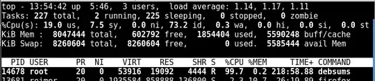

I let it run for 18 hours first time, and got no new results after the first couple minutes. I closed that down, re-ran debsums_init, and tried again ... with exactly the same outcome. Checking top on the process, it shows me this:
top output
So, should I expect this debsums -cs to finish its work and exit to prompt? Or is it hanging? or has it told me everything it's going to tell me, and I should just kill it?

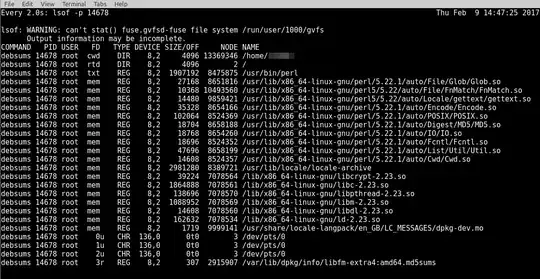

The output of watch lsof -p PID is static, and hasn't changed since it started:
watch lsof
