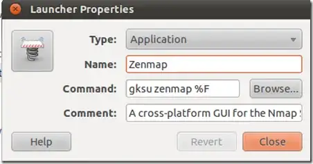

Use gksu in your launcher
gksu zenmap
gksu nmapfe

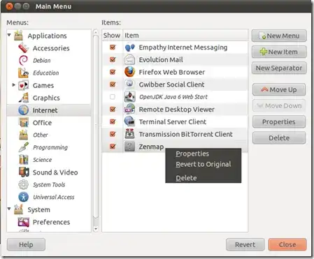

You can edit the zenmap launcher with alacarte. Screenshots of alacarte and configuration of the zenmap launcher:
sudo apt-get install alacarte
alacarte
gksu zenmap

sudo apt install zenmap alacarte
Then either type alacarte in the terminal or open it through the apps drawer
Click on the Internet icon as shown above, then click properties
In the Command: text box type
su-to-root -X -c zenmap %F
