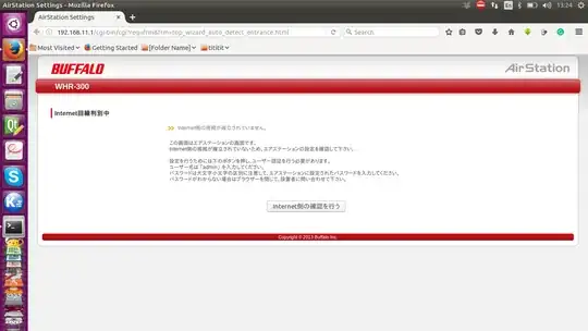

In all the three cases every time I try to open firefox web browser I receive this screen
screen
As done at the end of this post I attached here all the informations I could be able to give you in order to better help me.
