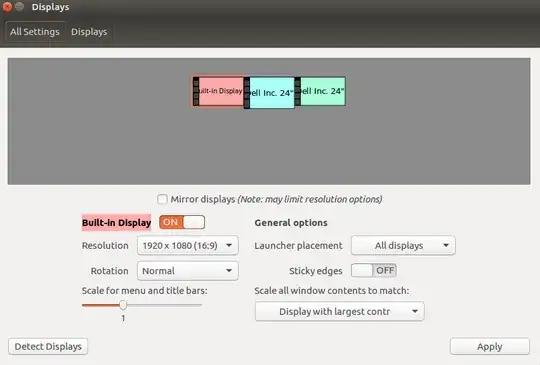

Use the native Displays settings panel:
Displays Settings
You can open this by going to System Settings and selecting Displays, or by just searching for Displays in the Dash.
