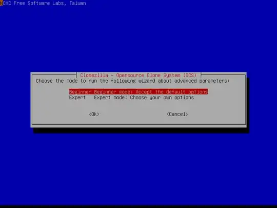

  1. create a Clonezilla live USB, using iso file and Unetbootin, or by building the bootabl manually as explained here
  2. clone your entire disk-source in an external HDD or SDD divce by
    • follow clonezilla/01_Save_disk_image tutorial
    • but when you got this message about expert/beginner options, choose Expert mode, so that you can enable the encryption enter image description here
