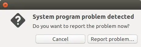

no progress, in addition to that now when I try to open the printer from the System Settings -> Printers -> Select Device , I get this message:
System Problem detected
Do youo want to report the problem now?
