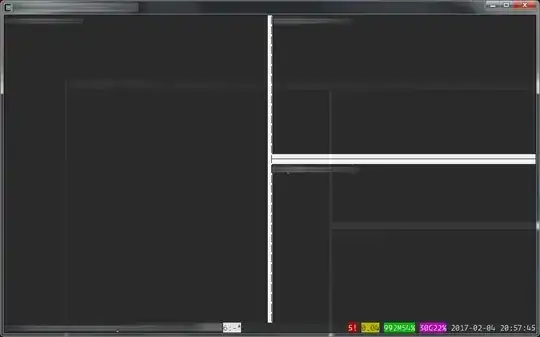

In byobu (with tmux as backend) I accidentally pressed the Ctrl + Shift + F12, activating the Mondrian squares easter egg. I did close all splits opened by that "feature", but from then on, all existing windows and splits in byobu are not displayed correctly.
There's a white line between all splits, and the current input focus is no longer visible. (i.e., when I press Shift + Arrowkey, nothing visibly changes, where there used to be an orange line next to the active split).
I looked through files in my ~/.byobu directory, but none of the recently changed files contained anything that looks related.
I'm running byobu version 5.106, tmux 2.1, Ubuntu 16.04.
This is a headless server, and I access it via cygwin/ssh, but it's the same if I ssh into it from an Ubuntu machine.
Screenshot of the issue

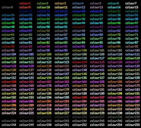

Note that the international (English English) spelling of colour is deliberate. If you have a recent version then you can use the American English color instead, but this was not always the case so may be best avoided for compatibility.
For a list of the standard colours, see the image below. You can also use HTML-style six-hex colour codes if you want finer control (again this does not work for older releases, but you are unlikely to have a release that old) like so: F12:set -g pane-border-bg "#ffdd00"enter.
tmux standard colour palette
